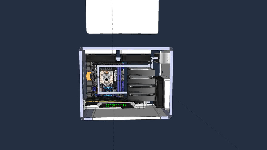

Case needs a bit dremeling:
- 5.25" support bar needs to be cut open from motherboard side almost completely
- 120mm hole to roof, I left enough fan spacing for power supply cable routing. (Actually used wrong online cutout paper but heck, doesn't make it any less better)
Using following components:
- 3x 120mm AIO 25mm thick radiators! (Clearance issues with copper 30mm otherwise!)
- 2x AIO block & water pumps in series (repurposing, there is room for a small pump between resevoir and front 120mm)
- Alphacool single bay 5.25" rev 2 (short)
- Made tubing plans with 10mm rigid tubing, I am going to use flexible 1/4" ID and 3/8" OD tubing (6.4mm/9.6mm)
- Able to use strange ITX boards
- Able to use full length VGA cards
- Able to use 4x 3.5" HDD's
- Able to use single 2.5" HDD/SSD
- Able to use regular ATX PSU (full modular is ideal with less than 150mm length)
Using shared warehouse models to model the case and components, I have no rights for them!
